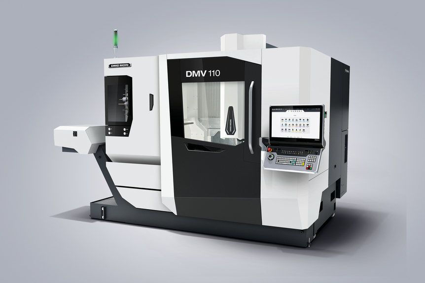

In the new DMV series, DMG MORI combines the strengths of earlier 3-axis machining centers with pioneering innovations that meet the increasing requirements in manufacturing.
The development of the DMV 60 and DMV 110 has thus been closely aligned with the Machining Transformation (MX). Based on the four pillars of Process Integration, Automation, Digital Transformation (DX) and Green Transformation (GX), DMG MORI is shaping the future of manufacturing with this concept. As 3-axis machines, the two DMV models occupy an important position in numerous industries – wherever high-performance machining of precise workpieces with simple geometries is required. In this way, they are proving to be a valuable building block in a competitive production environment including die & mold, medical, automotive and aerospace sectors, among others. In these industrial fields productive machining of the most common materials, from aluminum and stainless steel to titanium alloys, is crucial.
The travel paths of the DMV 110 are 1,100 x 600 x 510 mm, and the table can be loaded with workpieces weighing up to 1,700 kg.
Stable basis for efficient machining of precise workpieces
The optimized monolithic machine bed of the DMV machines, solid cast parts and roller guides in all axes ensure high rigidity during machining. The 1,400 x 600 mm table can be loaded with up to 1,700 kg in the case of the larger model (DMV 60: 900 x 600 mm, 1,000 kg), meaning that the DMV models are designed for a very wide range of components. The travel paths of the DMV 110 are 1,100 x 600 x 510 (DMV 60: 600 x 600 x 510). The machine is available with the full range of spindles: starting from a 12,000 rpm spindle, through a 15,000 rpm high-torque spindle, ending at a speedMASTER with 20,000 rpm – all of them with BIG PLUS interface. A combination of powerful spindle with high dynamic and rapid traverse of 42 m/min results in great cutting performance. Direct drive transmission in the X and Y axes and direct measuring systems in the linear axes ensure high positioning accuracy, which in turn increases machining accuracy. The same applies to the optimum temperature compensation, which ensures high thermal stability.
