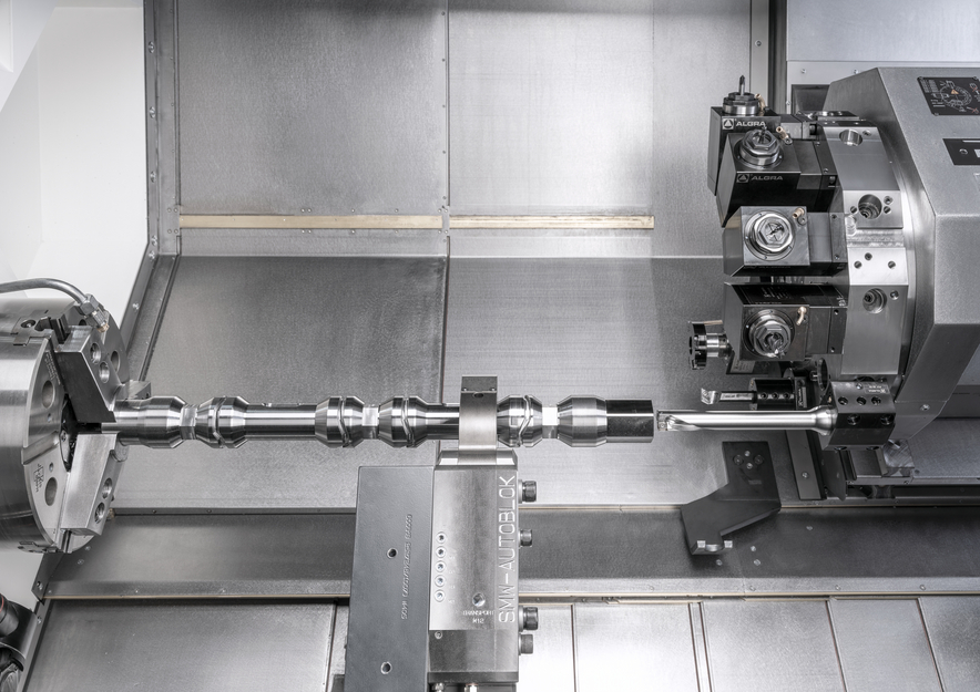

The CTX 750|1250 offers sufficient space for ø 700 x 1,290 mm workpieces on an area of just 11.7 m².
The spindles of the CTX 750|1250 play a major role in high-performance machining. The left-hand ISM 127 spindle with 2,500 rpm and up to 1,975 Nm torque is contrasted by an ISM 80 spindle. It achieves 4,000 rpm and 360 Nm. The spindle bore is Ø 127 mm, for bar Ø 125 mm. An ISM 102 spindle for 6-side heavy-duty machining with a torque of up to 770 Nm is optionally available on the right-hand side. The VDI-50 turret with twelve tool positions, used as standard, enables the milling operations required for 6-sided complete machining. The driven tools reach 4,000 rpm and 48 Nm. Alternatively, a high-speed turret with 66 Nm and a direct-drive turret with 86 Nm are available for speeds up to 6,000 rpm.

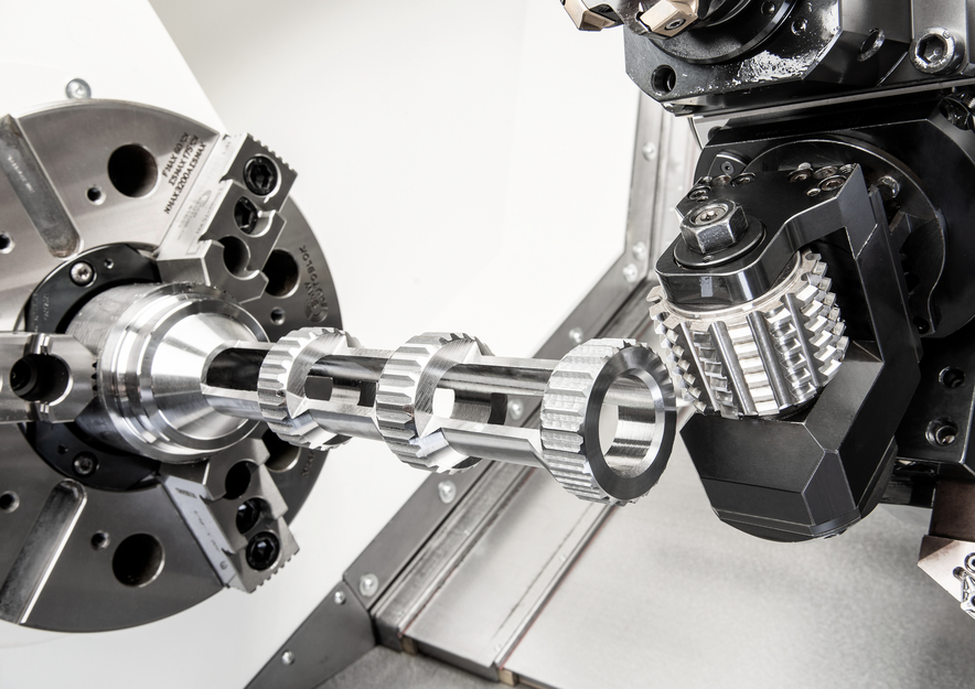

Integrated processes and energy-efficient machine utilization are just as much a part of the overall concept of the CTX 750|1250 as modern control options and automated production. The machine is optionally equipped with CELOS X on a SINUMERIK ONE or with an alternative MAPPS Fanuc. Both variants allow intuitive programming and fast machine set-up. DMG MORI Technology Cycles, such as gearSKIVING and gearHOBBING, facilitate the programming of demanding processes and expand the production technology possibilities of the CTX 750|1250. Production gains additional productivity through autonomous operation in three shifts. A wide range of automation solutions are available to users – from bar feeders and Robo2Go Max to the MATRIS system, which can be used to create complex production cells.
